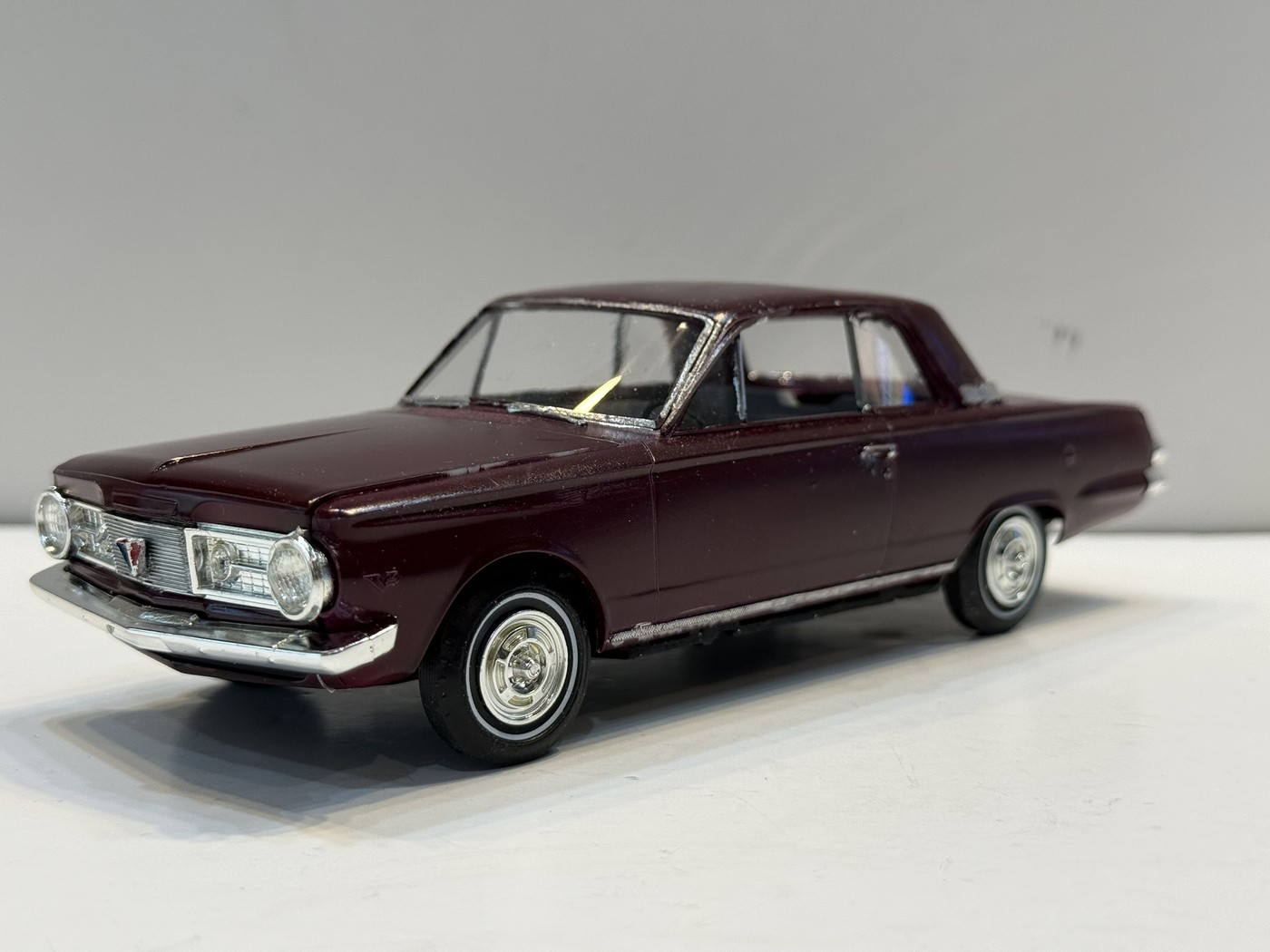

Well, it’s been a Valiant effort and it’s finally done. *PIX*
My favorite 3D artist Andrey Bezrodny on Cults 3D produced these Valiant models. When he first introduced them, he offered them at half price. At $11 bucks each I couldn’t pass them up.
While Andrey provides a full kit I chose to use the new Baracuda kit as the basis and just use the unique parts from the 3D files to build these.

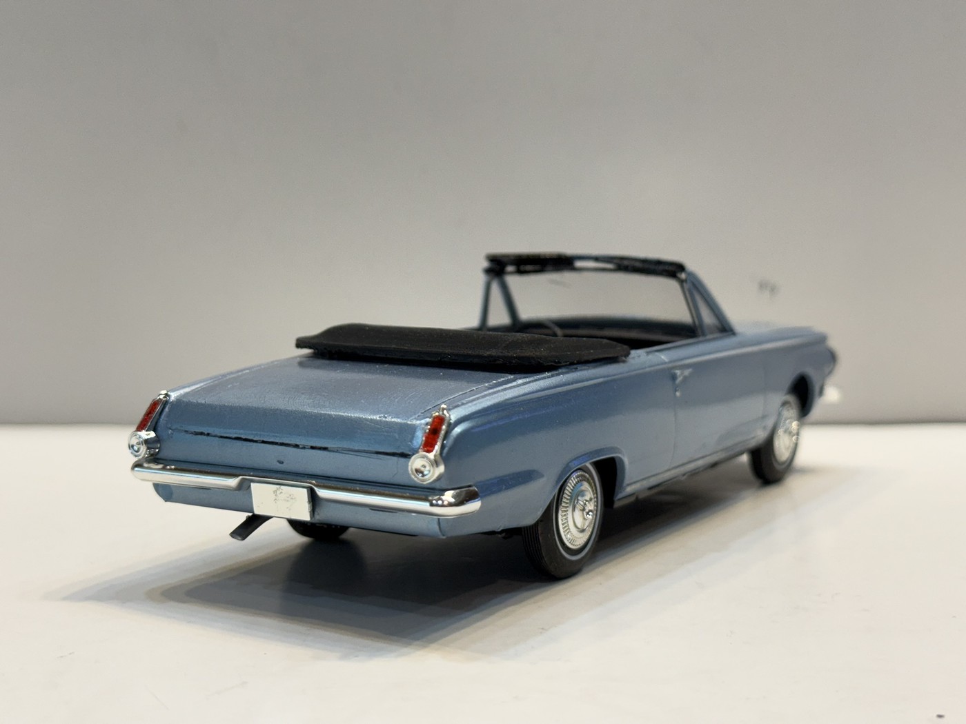

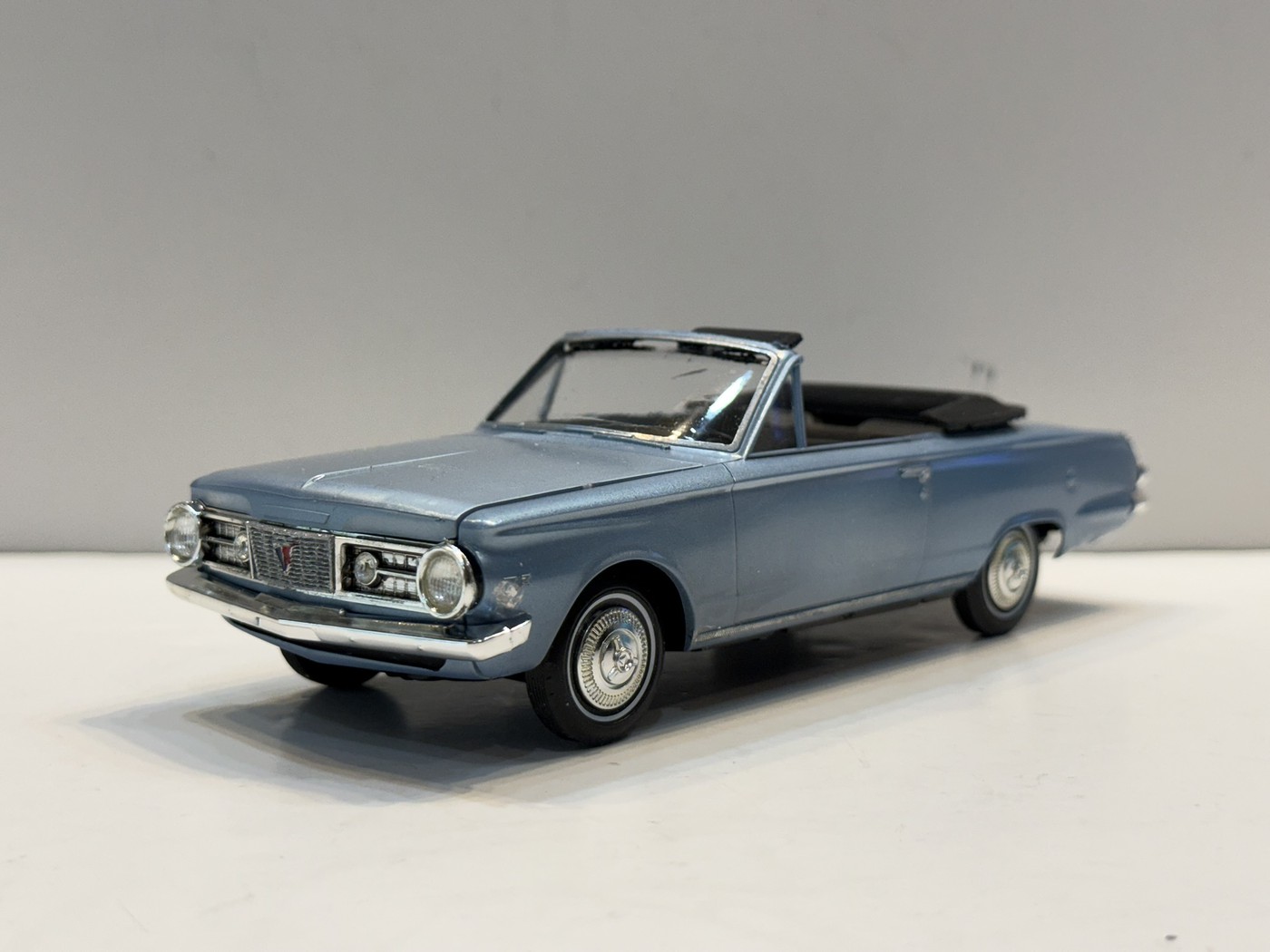

For the convertible I cut off the back of the Baracuda and grafted the rear deck from the convertible body.

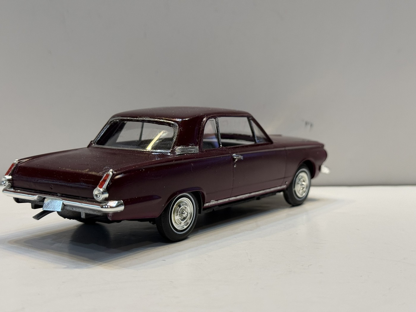

The 2 door conversion was done in a similar way by grafting the roof portion onto the Baracuda body.

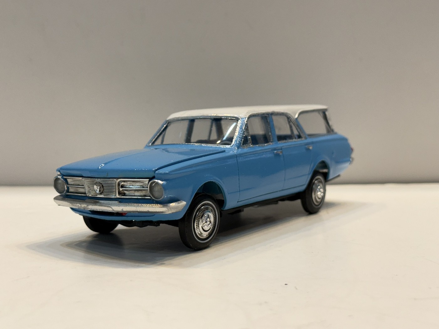

I chose to use the full print of the station wagon body and interior.

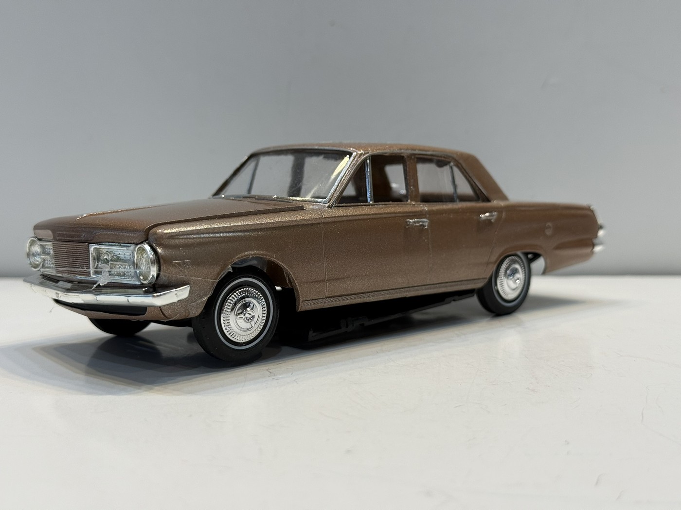

The 4 door version was probably the most challenging conversion. I grafted the roof section on much the same as the 2 door. It required me to change the door lines as well as create the door handles.

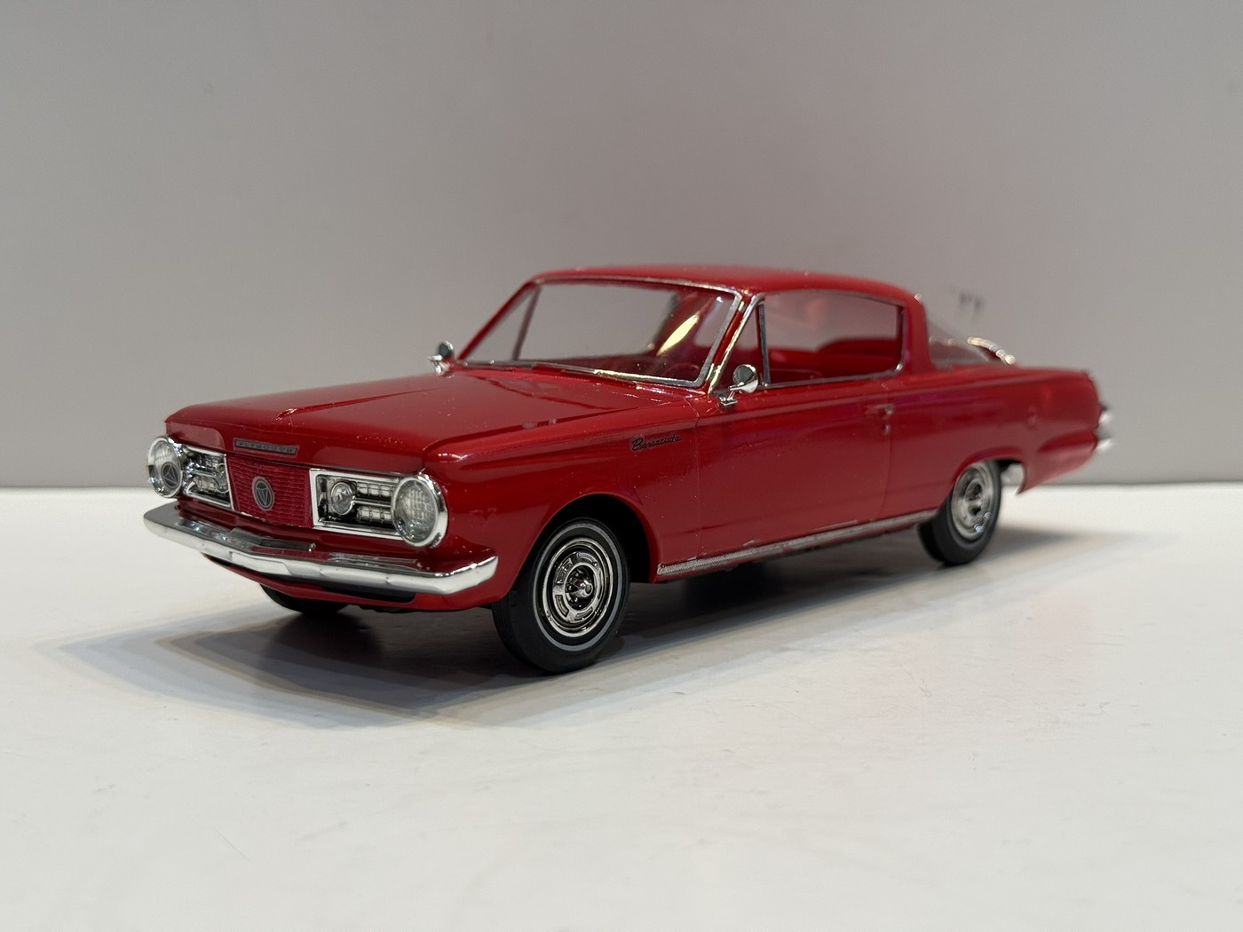

And finally, while not strictly a Valiant it really fits here. Built straight out of the box.
