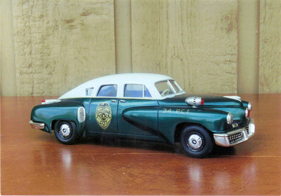

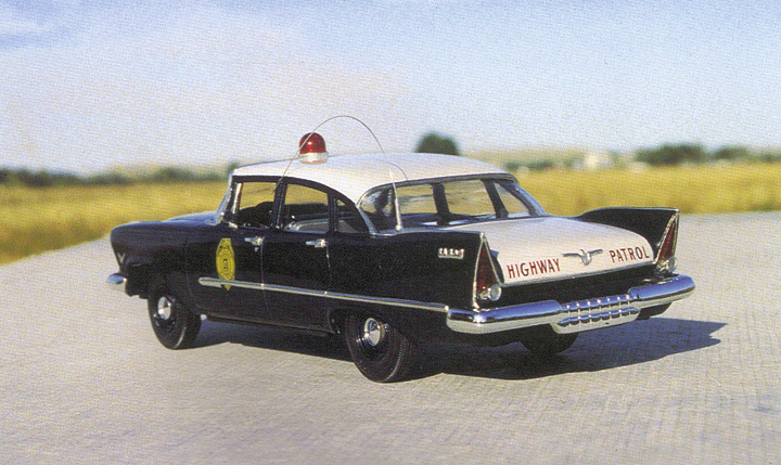

Here are two examples of paint disasters that I saved using it.
On this Plymouth the spray can decided to spit blue paint out in long strings. Made a total mess of things.
On this I didn't prep it well. When I peeled up the tape for the second color, the paint peeled up with it.
Both times non-acetone nail polish removed and a cotton ball saved the day. By the way, do this in a well-ventilated area. That nail polish remover REEKS!
