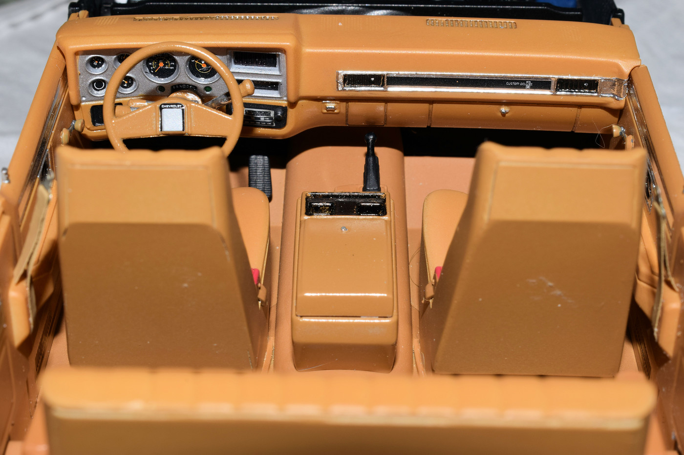

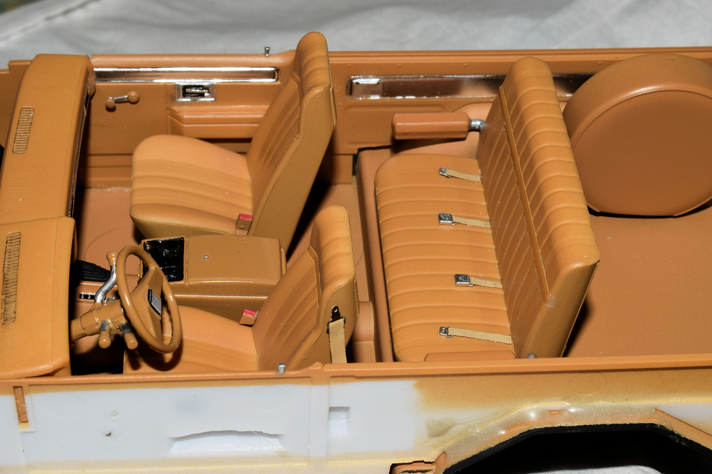

INTERIOR--MCW Buckskin Lacquer, modelbehaviorstore.com belt retractors/cranks (2 pcs.)/back seat hardware, scratched shoulder belts, couldn't find trim package references (my treatment is wrong, I'm sure)

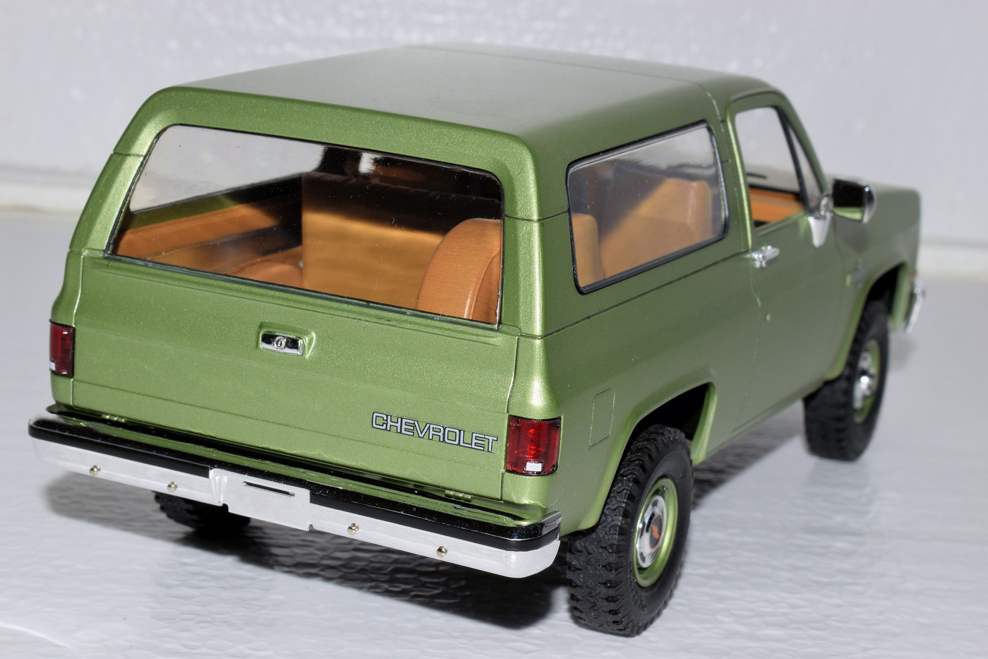

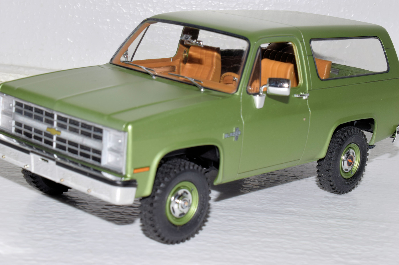

EXTERIOR--MCW Gloss Gulf Green Metallic Lacquer (85 OEM GM color but not for Blazer), Iceman Coll. wipers (kit ones short-shot), scratched bumper bolts (sequence pins), black decal strip on bumper to replicate rubber insert, Scenes Unlimited Town & Country Tires (kit ones real clunky), didn't clear it--finish glossy enough for factory stock--flat black wash in all panel lines & cowl vent, grill shot with Vallejo Silver--Warbird chrome decal strips around perimeter--too shallow to hog out grill from back--colored with Coptic Black Liner--shot with Life Colors Flat Clear for depth, had to file all glass and lenses--too wide/thick to fit easily--glass and rear lenses edged with AK Rubber Black marker--backup lense is a decal--fit perfectly but a bit too white

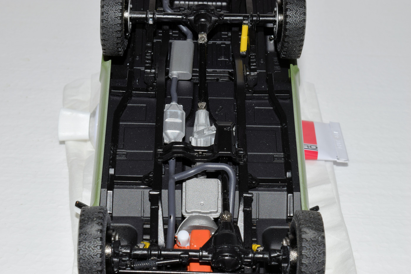

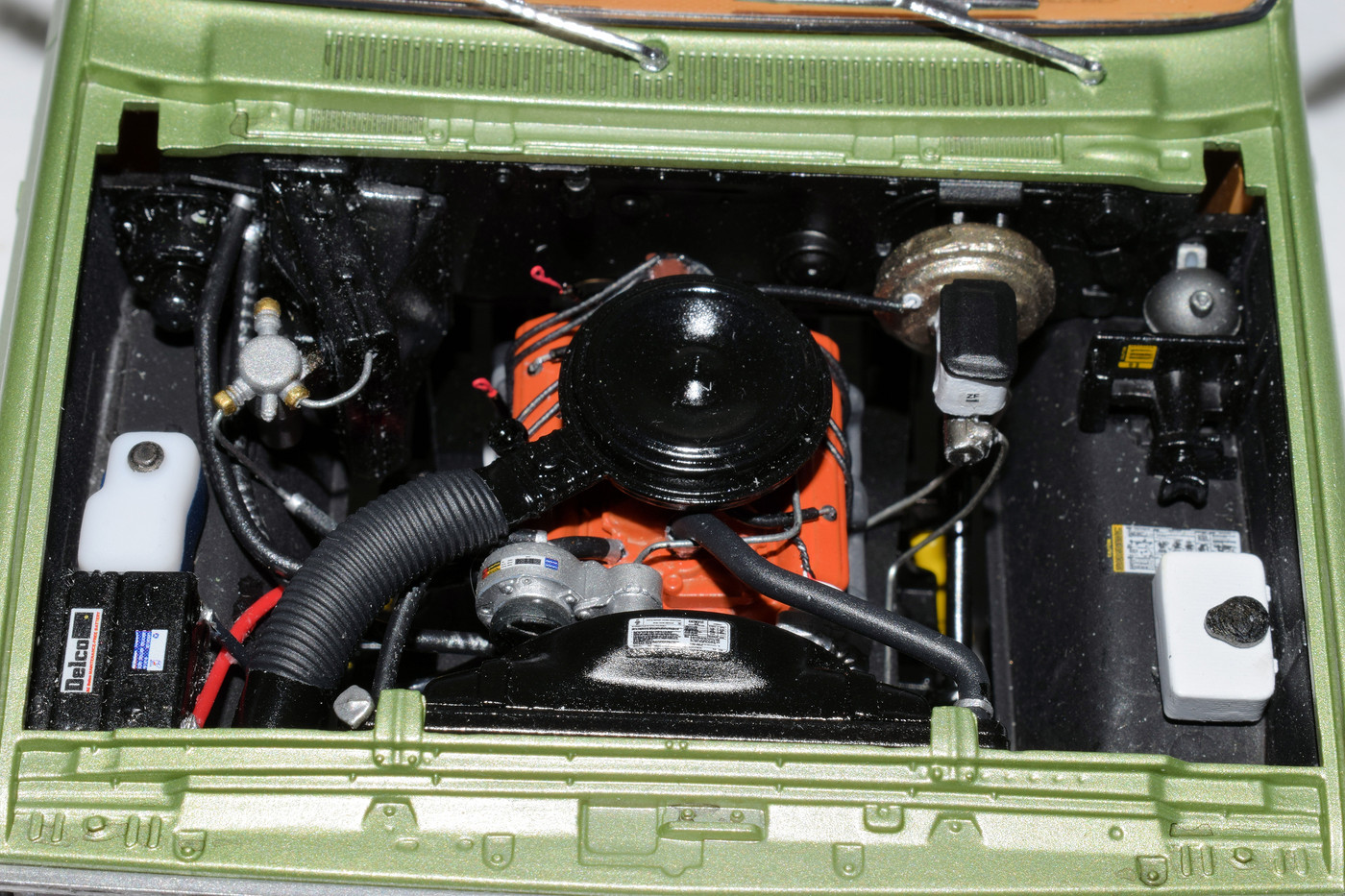

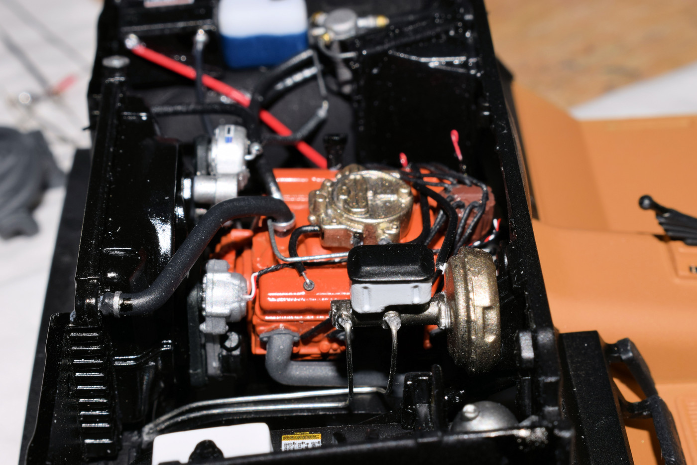

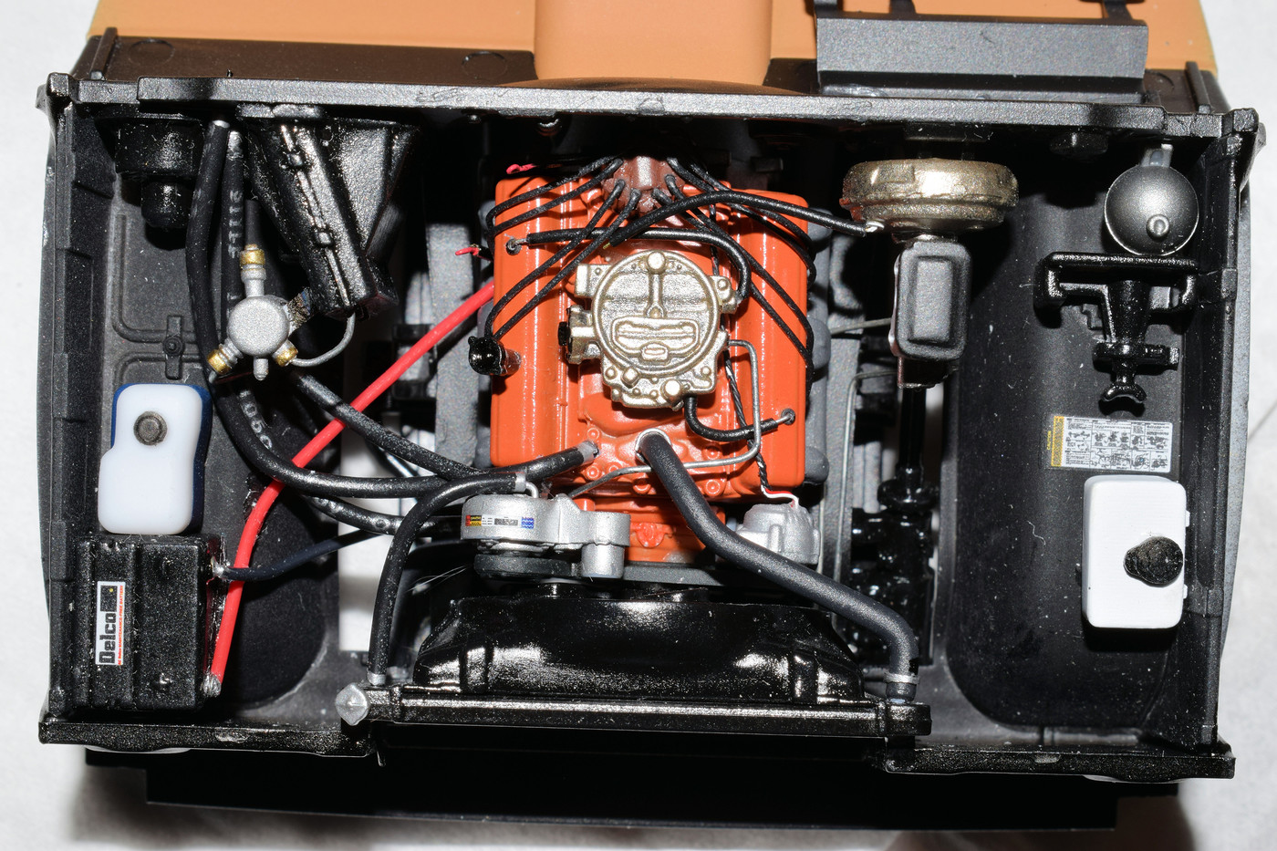

ENGINE BAY--plumbed & wired as best as I could do (yes, I know it's incomplete & inaccurate)--figured out how to replicate more accurate vacuum lines (well, I think so, anyway), scratched tranny & oil dipsticks, plumbed A/C (did 2 of these--my 1st and MY LAST)
THOUGHTS--think Tamiya/Nu Nu/ICM quality with full engine and chassis detail, full complement of engine bay and interior decals (fit perfectly but release from paper very quickly), designed/tooled as good as anything I've ever built BUT you'll play hell getting axles level/plumb so all 4 wheels touch, sorry for the pic quality--best I can do
