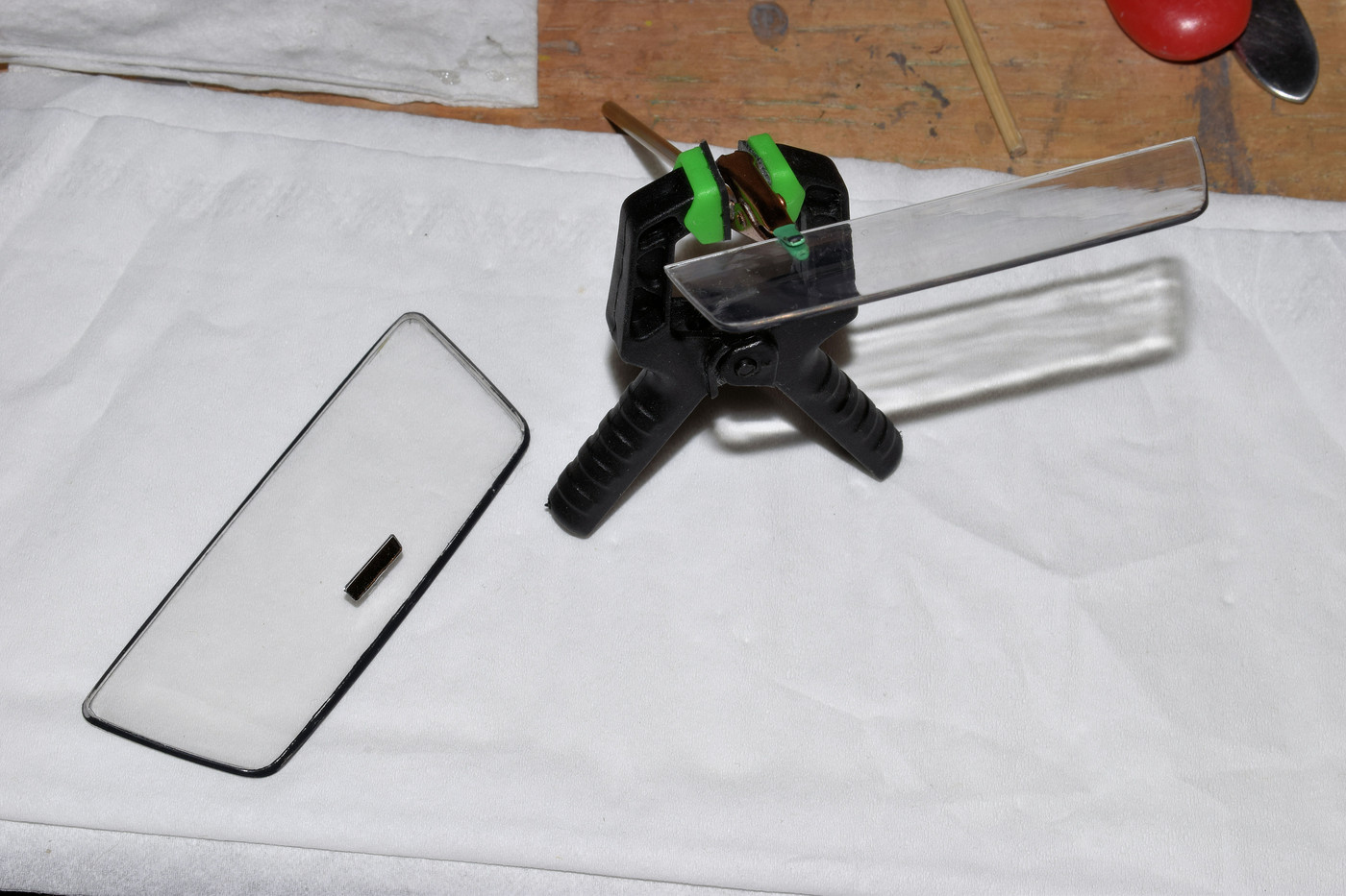

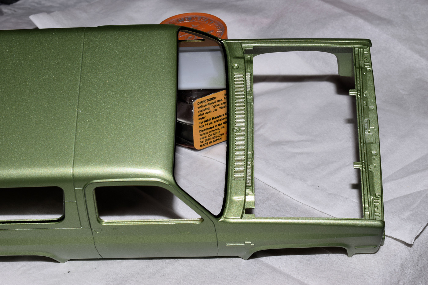

Install glass from outside

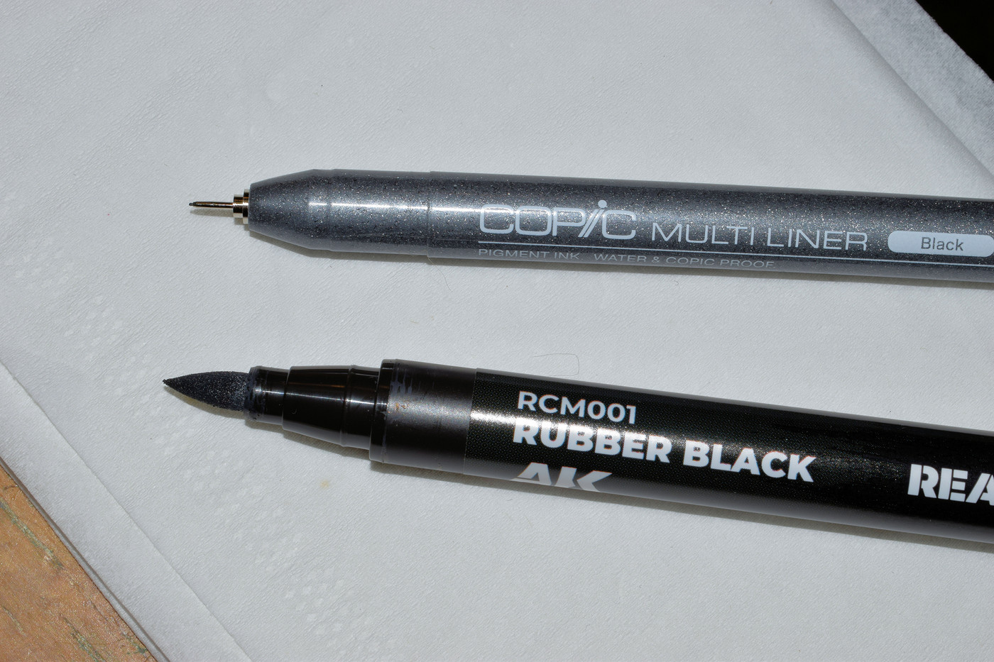

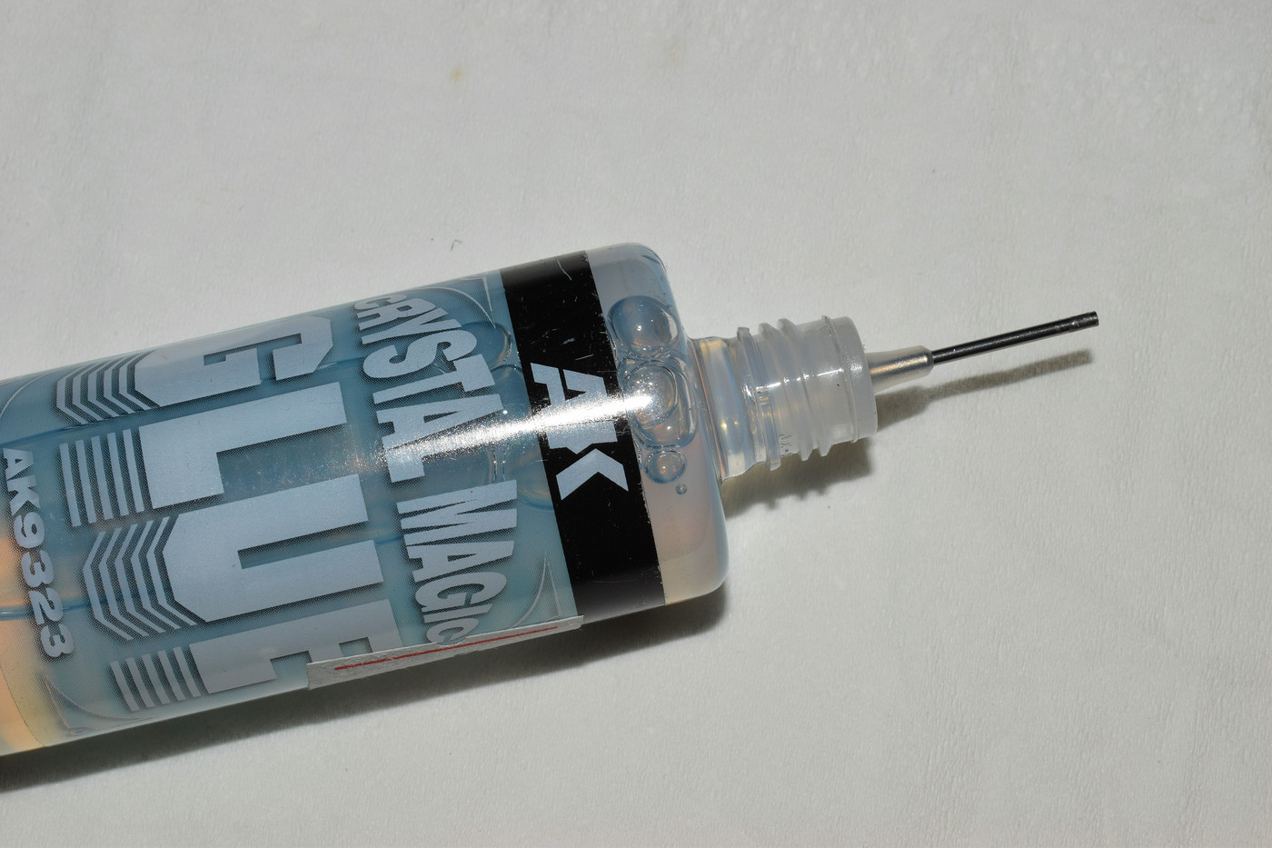

Scott was asking about glue showing through. I don't think glue is the issue. I file the backside and outside of the glass with a bevel angled toward the inside. Glass seats better and coloring with marker is cleaner. Also run panel liner along inside groove on the body. Glue won't show
