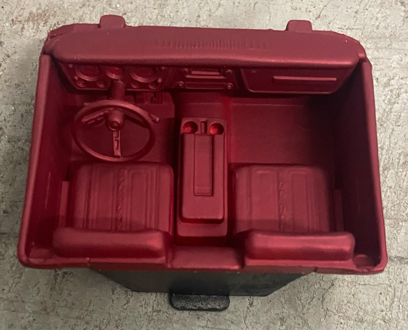

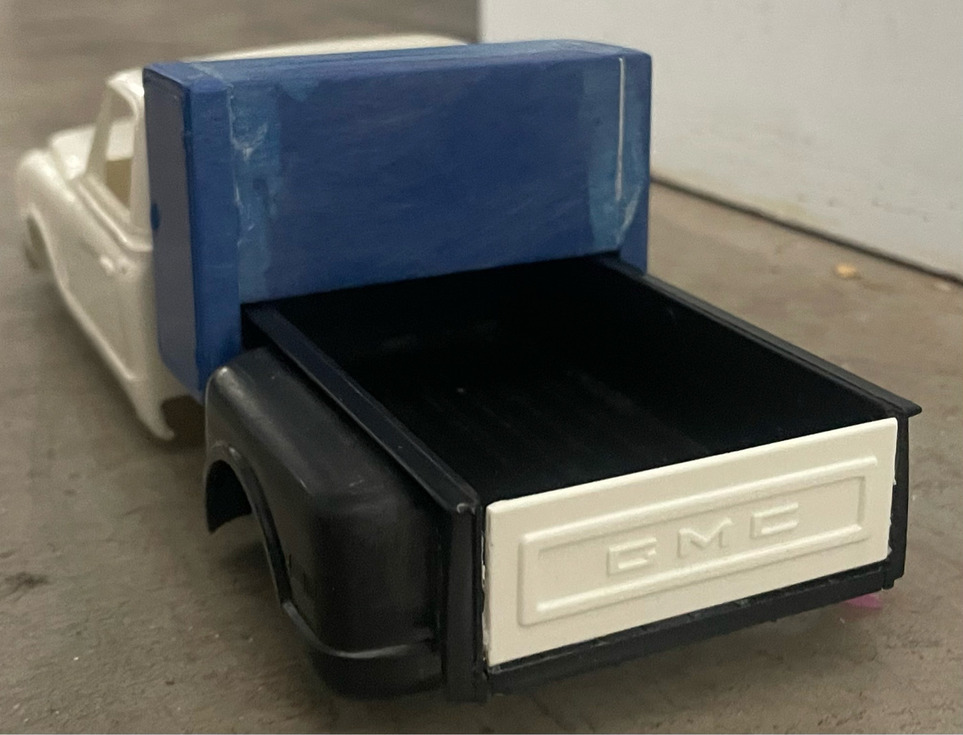

The bed is straight from the MPC but with the GMC tailgate from the AMT kit. The interior is from the GMC kit but I added a floor console from an MPC 1979 Chevy pickup kit plus a steering wheel and column from my stash. I don't know what kits those items are from. The console fit perfectly with no modifications. The interior is painted Duplicolor metallic red over gray primer and overcoated with Tamiya clear flat.

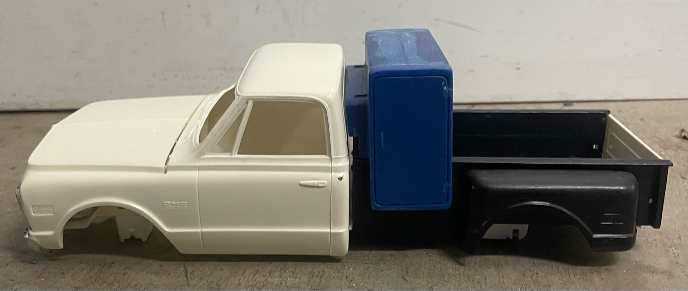

The bed mounted sort-of sleeper/cargo box comes from the MPC Rolling Thunder kit. I am in the process of cleaning up the gaps to make it look smoother. I will be using Micro Liquitape to attach it so I can remove it as I choose.
In essence Stepper is a whole kit-bash model and that is often much more fun to me than just using one main kit.
Stepper is a curbside, light commercial build (auto parts store delivery truck). I am making steady progress although I still haven't decided on wheels and tires.
