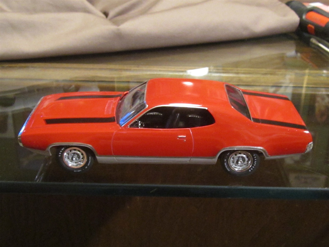

Shaft's car was the inspiration for me to build this. .......... *PIC* .....

Looks like Shaft's Sebring *PIC*
That has the optional hood and trunk stripes that were available on Satellite as well as Roadrunner. Cool. *NM*

VERY nice build! Man- they drove the heck outta that car in that flick!!! *NM*
Scott, which kit did you use to build that? *NM*
I used the MPC 1971 roadrunner. I bought a resin Satellite hood and a resin 1972 rear bumper and taillights. Harts Parts has the 1972 rear bumper and taillights. I forget who had the hood. Maybe Harts Parts again? *NM*
Harts Parts doesn't have the MPC 1971-72 Satellite hood. But he has a Satellite hood for the Revell/Monogram roadrunner/GTX. Maybe you could trim it down ? *NM*
Thanks Scott! Your Satellite looks great! I would like to see Round 2 reissue/clone the MPC '71 or '72 Roadrunner again. Years ago I made a Satellite hood by carefully trimming the Air Grabber bump from the center of the hood and replacing it with flat styrene, leaving
The stripe decals were offered from a decal company that I can't remember the name of. If I remember right, they have been out of business for a number of years. If I can think of the company, I'll let you know. *NM*
That’s fine, Scott! I was just curious. I don’t have the kits and parts necessary to do one of these now, anyway. Thanks again!! *NM*
