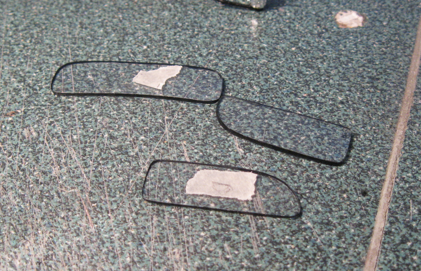

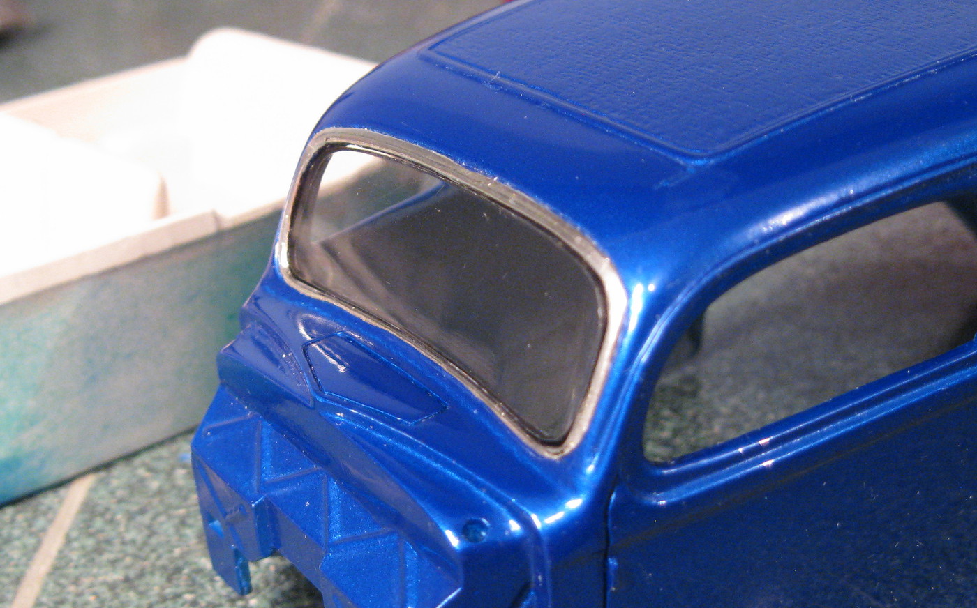

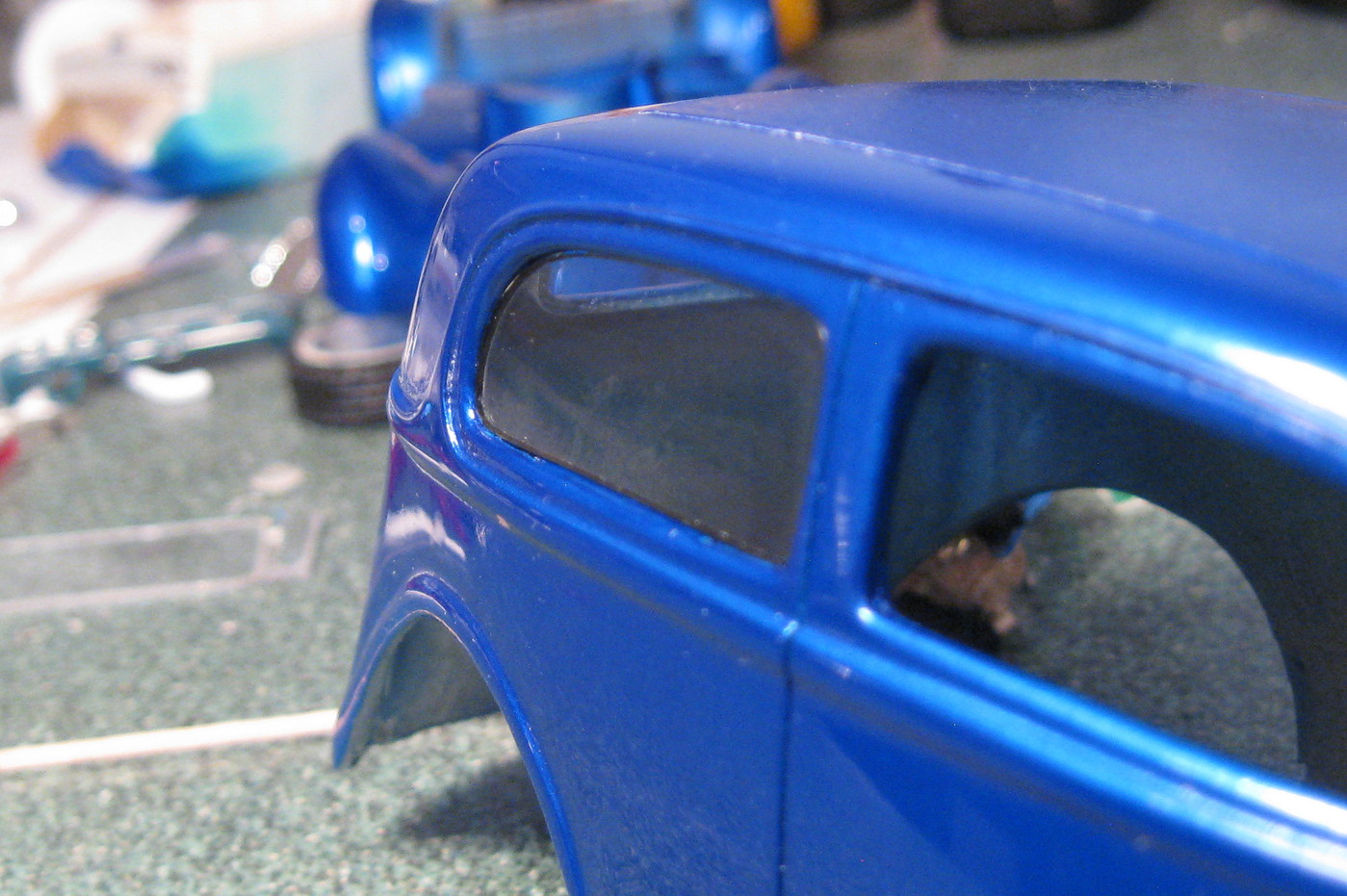

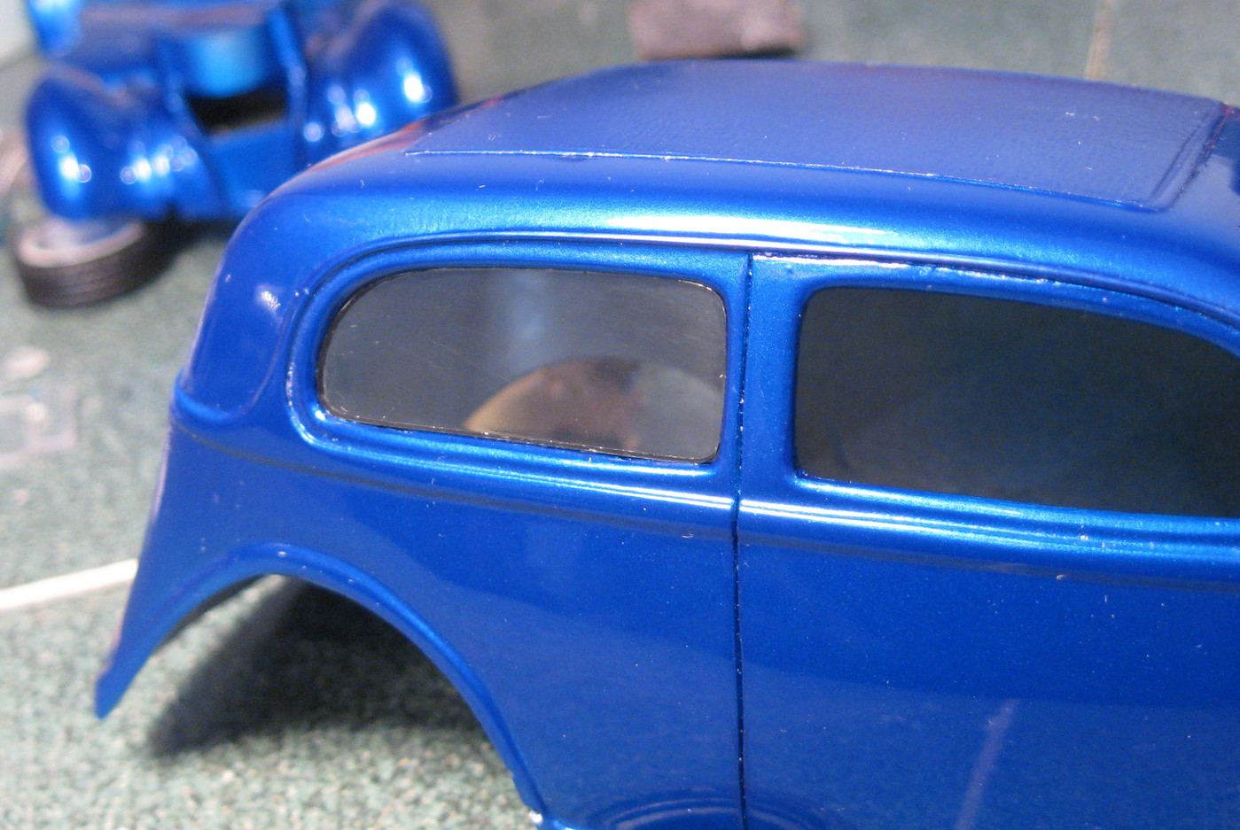

Was planning to install sheet plastic windows from the inside as you would normally do but the casting is so thick that it just wouldn't loon right, Ended up cutting windows from old kit windows.
Rough cut them and ground them down to fit with my Dremel and did the final fitting by slowly sanding and fitting with a file and sandpaper. Did the edges with black paint so they wouldn't show light against the paint. They friction fit and I glued them in with thinned Tamiya clear acrylic.
After it thoroughly dries for a couple days I'll go back and run more clear around it to seal up the gaps.

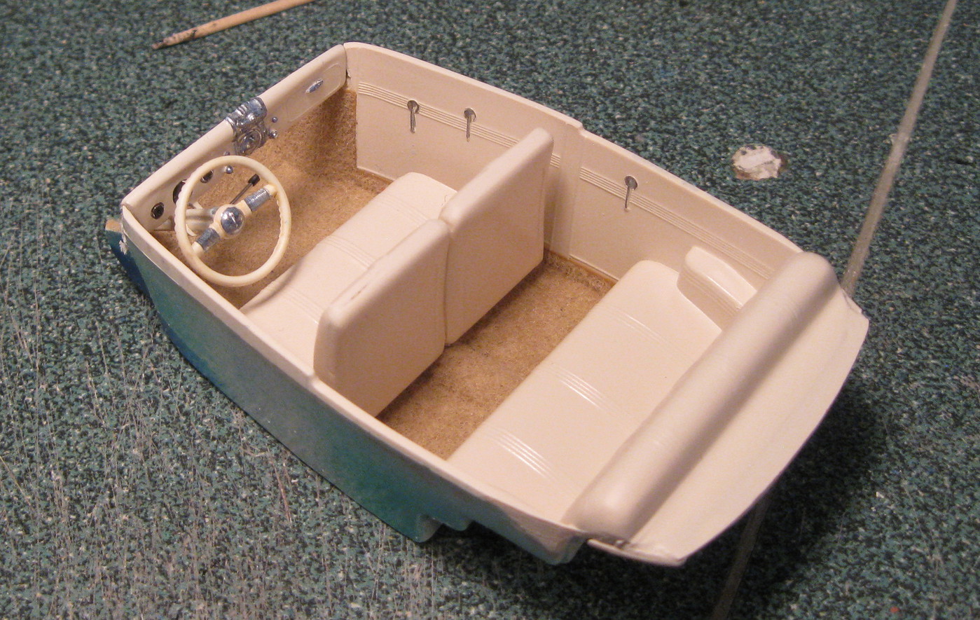

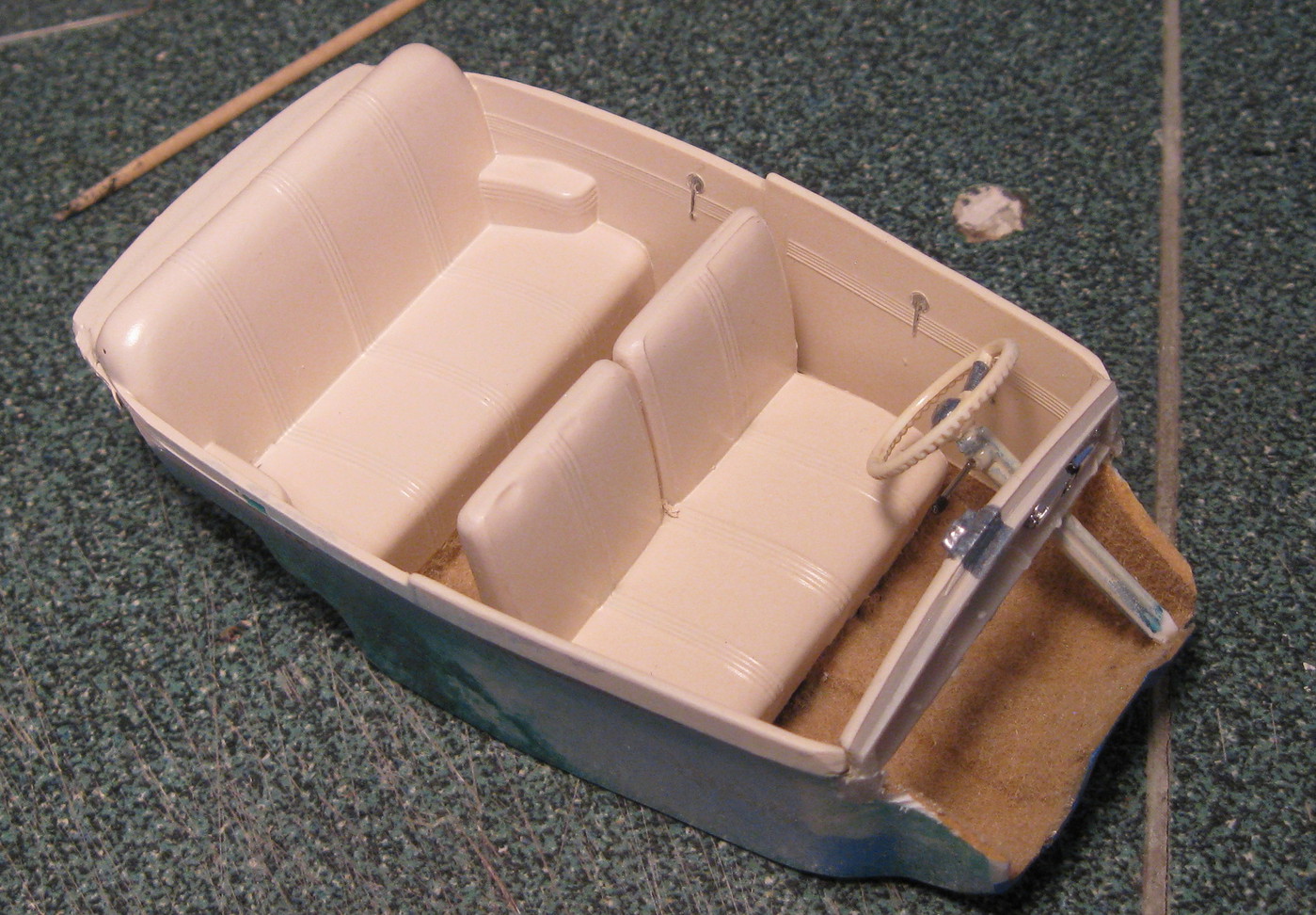

Finished up the interior. Simple light tan with tan flocking. Dash is the kit part with the '40 interior steering wheel.

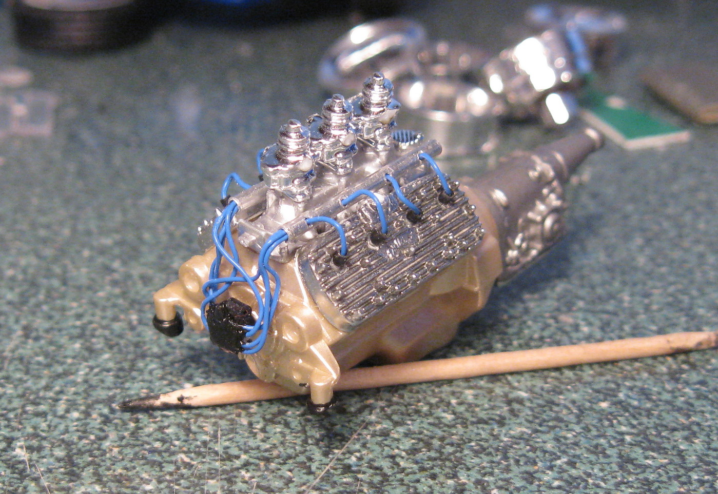

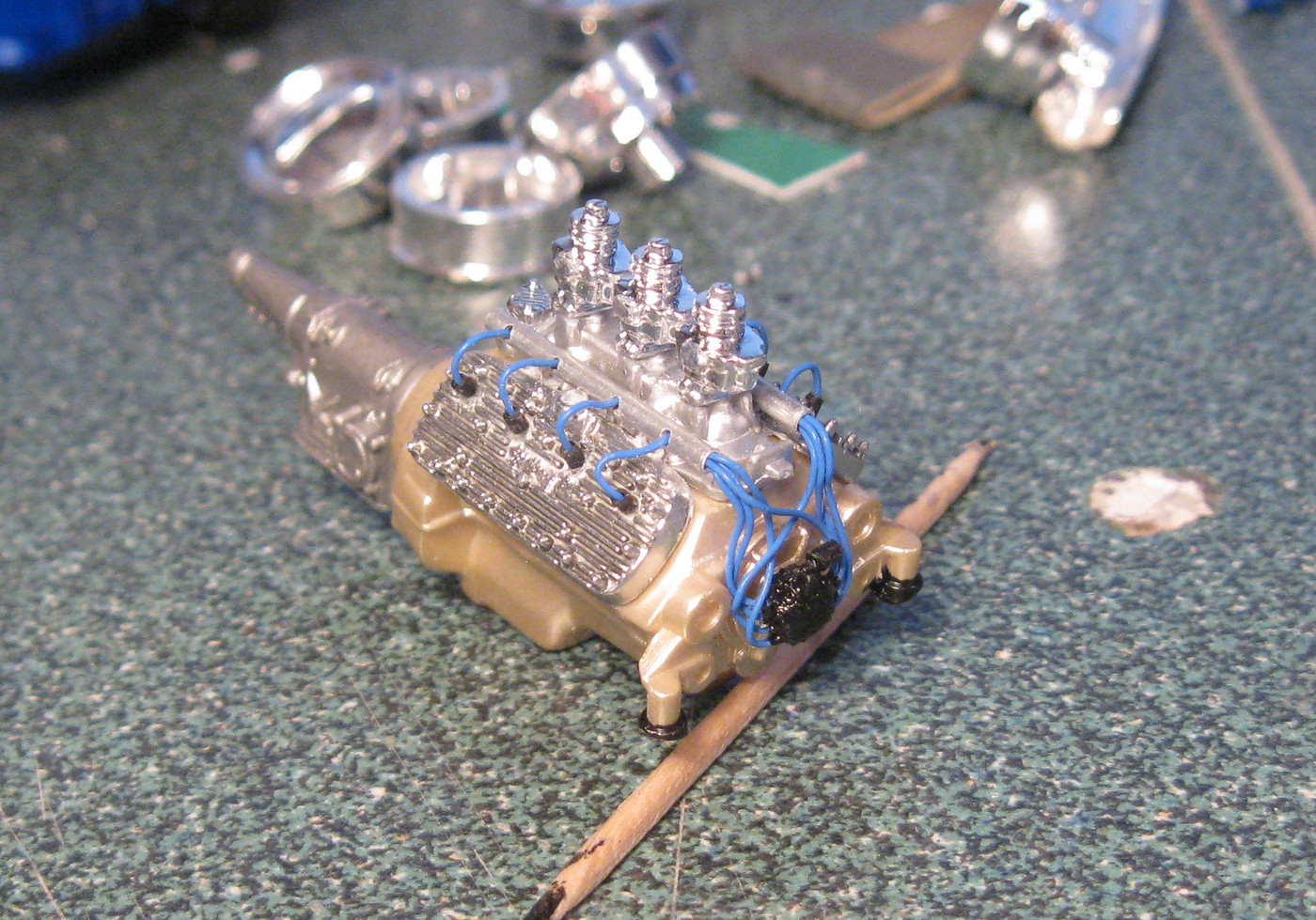

I also did the plug wires on the engine,,
