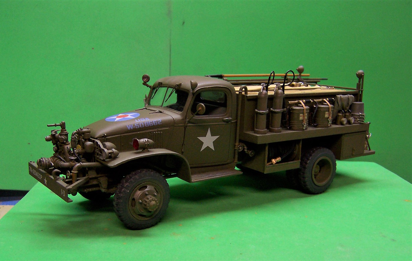

I have built the Army Class 325 pumper twice already, one of which went to Hawaii and the other to Belgium. So this version is being built for the collection of military truck builds that are on my shelves. Here are the first two.
The Hawaii truck is now in Texas with the family of the WW II veteran that it was built for. He passed away last July at the age of 100. In real life a rig looking like this would have been built by Maxim Motors, notable for the rounded housings for the booster reels in back of the cab.
This is the second one that went to Belgium and is owned by a person who has a full sized restored Class 325. Other builders like Howe Fire Trucks also contributed. Note the different markings also, which are on the real Belgium rig.
